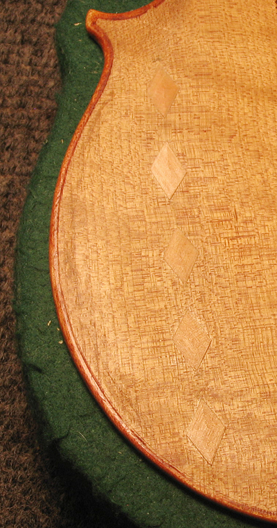

After gluing a split as in the top, no matter how good the alignment and how tight it has pulled back together after regluing, there will always be a slight crack in the varnish that shows especially when looking at it with light reflecting off it. I have been able to fill this type of crack to a perfectly flush condition (by french polishing) so that the finish is totally flush and the crack is not visible except perhaps very slight coloration.
The problem is that this is an incredibly slow and tedious process... is there a better way to fill any slight cracks so that the surface is smooth and unbroken???
here is an example of such a crack. the alignment of the plate at the crack is dead on...and at the right side you can see that the crack is almost invisible where the shellac has completely filled the void.... but then my arm got tired!

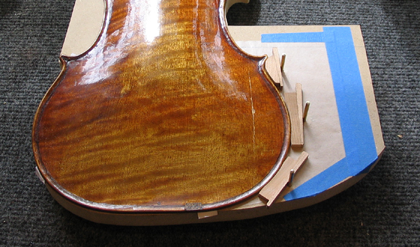

The violin was presented in this condition:

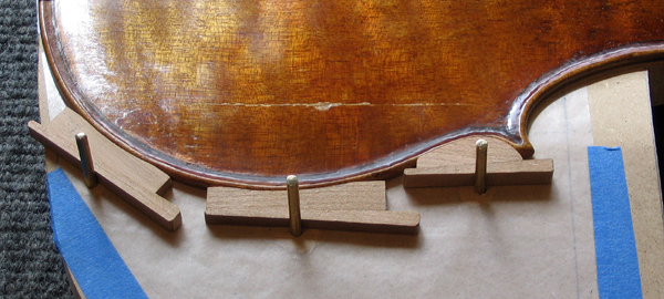

As sometimes happens when a break like this occurs, the arching on portion of the back that separated "relaxed" slightly. This essentially made the piece slightly longer, so aligning the lengths was required. To do this, I removed the back and spot glued it to a platform. The blue tape is holding down a piece of wax paper to keep the "free" part from sticking to the platform:
Then I installed brass posts and fashioned some pads and wedges to hold the ends of the pieces in alignment.

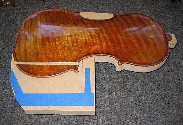

The center portion of the crack varied from square to bias through the plate and I felt it required some manipulation to ensure that the arch aligned correctly, so only the ends (from the edge into the purfling channel) were glued in the jig.

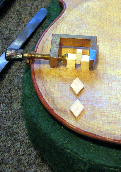

After removing the back from the jig, I used pillars, clamps and wedges to align the arch in three partial gluings, cleating the finished areas behind the work to ensure these portions would stay closed as I manipulated the plate when gluing the next section.
After the area was thoroughly dry, I shaped the cleats and moved onto the finish. They may be overkill, but when this amount of manipulation is required, I feel better with cleats... These are willow, and on the thin side.
