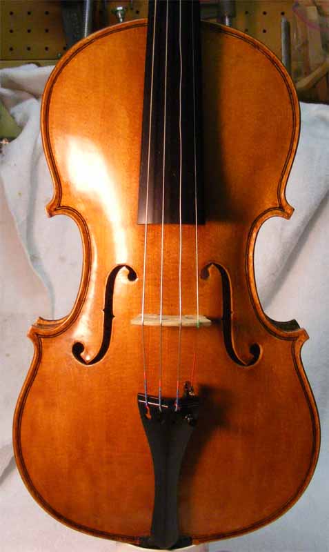

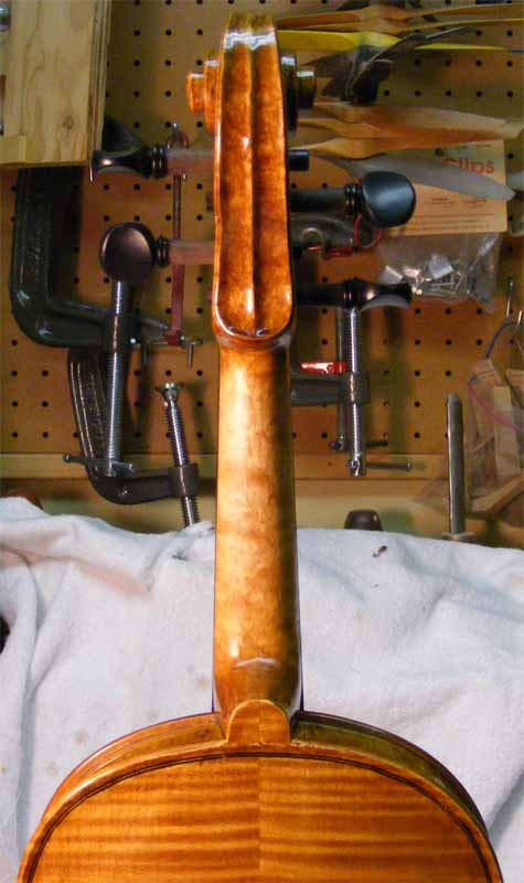

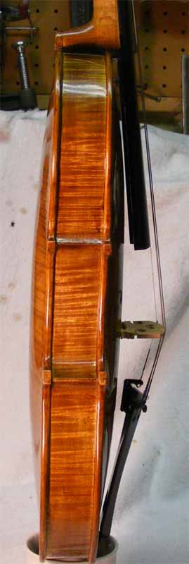

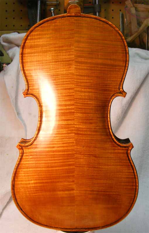

This is my first violin. I've spent the past 2-1/2 years getting to this point, however there were long stretches of time when I was not working on it, such as last summer when I spent the summer months furiously composing music in an effort to win a contest to replace the Hockey Night in Canada theme song on CBC (didn't even place!). Anyway, note that these pictures are not all that great, they hide a number of flaws, but I think this is "not bad for a first try" anyway. Sounds real nice, at least as far as I can tell - I don't (yet) really play, but I can do "Twinkle Twinkle". This violin seems pretty responsive, at least it's very easy to make nice notes instead of squeaks and scratches. It's based (VERY loosely) on the Kruse, at least that's the Strad poster I was working from. I'm aware I didn't come at all close - for one thing, this instrument is quite oversized at 14.25", it won't even fit in a standard case. The varnish is mastic/oil according to a recipe Michael Darnton has posted, with asphalt for color. The "ground" is 3 coats of orange shellac, applied with a rag, as if doing a spit-polish prior to French Polish. The bridge at the bottom is my first bridge carving. Anyway, here she is:

your varnish and color of it are great.
i love it, particularly the 1st and 2nd photos

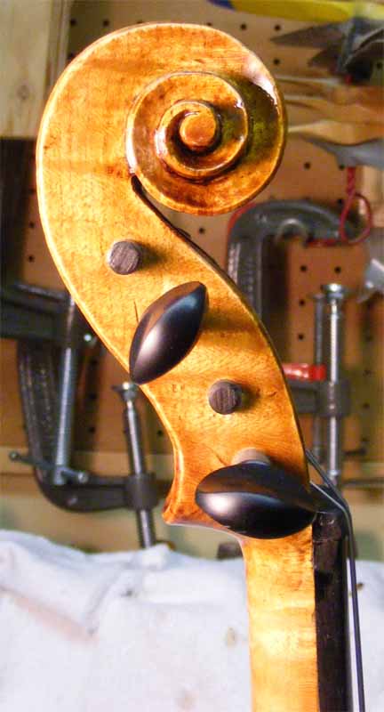

Tim Lots of good things to see there.The scroll is very well done as those curly bits can give some very unexpected results.

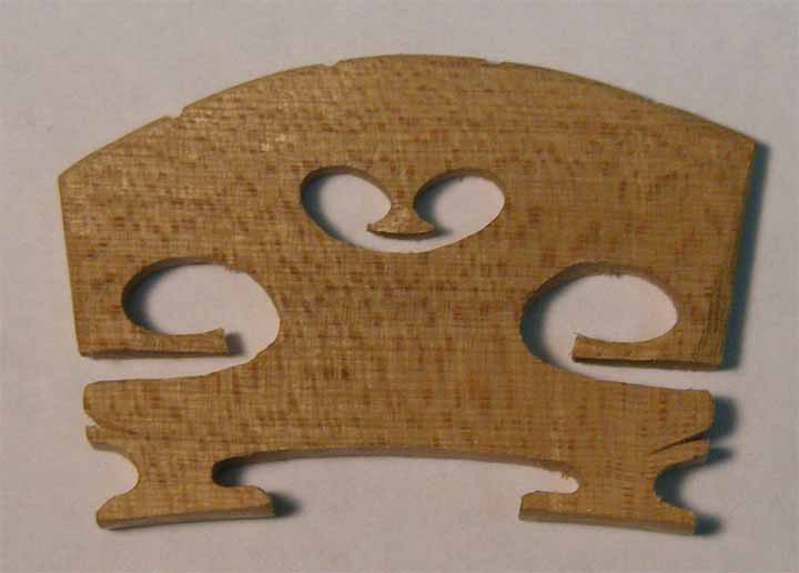

I gave a tip 2 days ago so I can repeat it for you .Get a diamond nail
file to thin down the top edge of the bridge.This will help with a bit more tone.

I really like the scroll work, nice proportions, nice line in the spiral. Great color on the violin too.
Something you might do is dress up the ends on the pegs. I take a large gouge (about 1 1/2" wide and just a bit of curve) and lay a piece of 320 sandpaper over it, and press the tip ends of the pegs into the paper and rotate the peg as I sand the tip down to a nice slightly rounded end. This takes out the saw marks. Then a piece of 600 or 1000 wet and dry and rub the tips till they are nice and glossy, then another round with some emory cloth. Its a great finished look especially when flush with the cheeks of the pegbox. I also put a little black water-base stain on the pegs where they've been shaved to really dress them up nice.

Tim It`s strange to be coming back to an older posting like this.I had another look at your bridge and the larger "dents" for the strings seem to show the G string is left in the picture.That would make the E string too high.Normally that is tilted down (for the bowing?).If you closely measure the bridge thicknessing from the internet measurements the tone will start to jump out where you may have settled for an ordinary sound. Also check out the subject of fitting the bridge feet. Also ,if the bridge picture is the player`s view the grain pattern is "normally "reversed.to this view.The vertical streaks in the wood are a vertical growth.The angle of the wedge shape is made by cutting wood on the fingerboard side.Unfortunately some makers have turned this around the other way. Whether it makes a difference I`m not sure.The new theory is that reversing makes the bridge less likely to bend with string tension.It will still move though.So does that give the poor old belly some grief??? Maybe a bendy bridge is a better alternative ,with careless players.
You have had a good advisor with the model. By the way the overall time taken is not that important.There is a teaching course where the students took three years to complete their first instrument.I can`t imagine how that works out.
